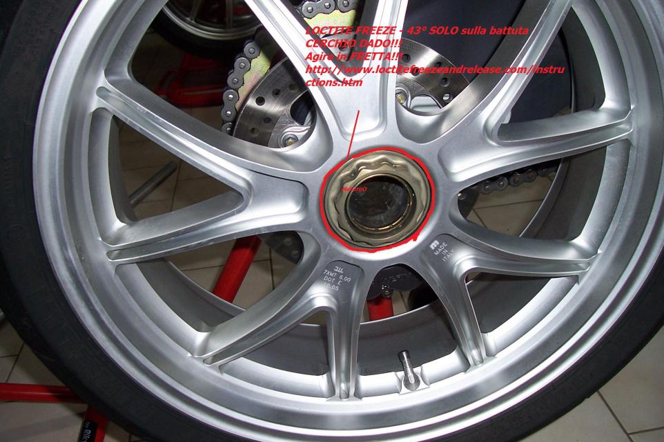

MeScHiO
Envoyé par MeScHiO Voir le message
Smontaggio ruota posteriore MV AGUSTA.wmv
http://www.youtube.com/watch?v=MczREdPVHlE
Loctite® Freeze
http://www.loctitefreezeandrelease.com/instructions.htm
: Cool:
I used this method for several times and it works perfectly!!!
Do not use inside the axle, but use it like in photos!!!
: Fumo:
Nom : SmontaggiocerchiF4B4005-or.jpg
Affichages : 935
Taille : 96,7 Ko
arrière, démontage, roue
